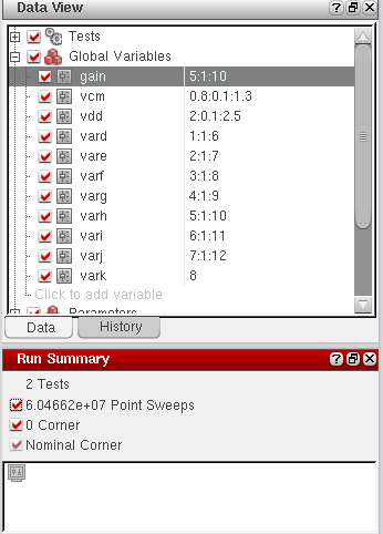

    I just tried in that version. I created a bunch of variables (with 6 sweep points in each). If they are not grouped, I get this:

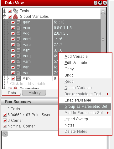

    There's no highlighting of the variables - the background is white, and you get the huge number of point sweeps. If  I then select and use the right mouse button menu:

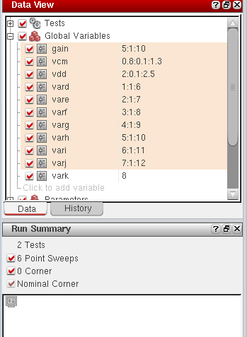

    Having done this, you see the grouped variables highlighted in the same colour (note the bottom variable is not grouped):

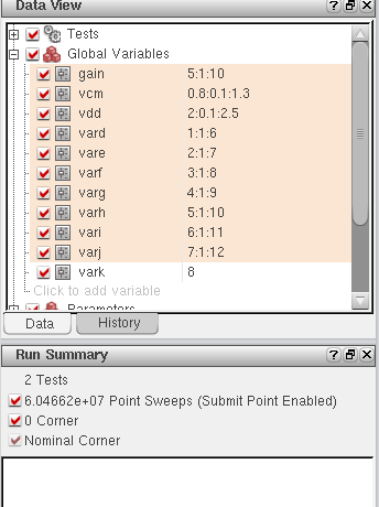

    As you can see, the number of point sweeps is dropped. However, your UI showed something about a submit point.

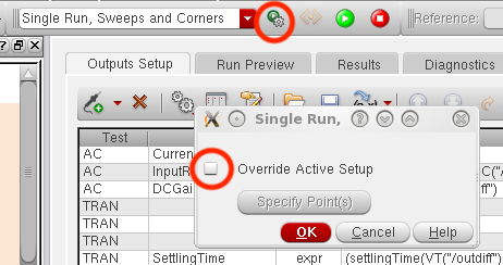

    So, if you go to the "gear" icon next to the run mode, and then click on this Override Active Setup:
    If you do that, it then ignores the group as parametric set (the sweeps are defined in the "Specify Points" UI).
    Note that the same problem occurs in the latest versions too - if you override the active setup from the Single Run, Sweeps and Corners options form.
    So go to that form, and turn off the "Override Active Setup". If you really need to override the setup, you can use the "Setup States" to save a set of variable sweep settings, and then load different Setup States to switch between them.
