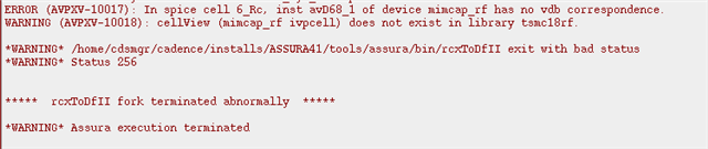

When I did RCX test at a certain design after passing DRC and LVS tests successfully, it failed.
the following pictures for the log file (at the start and the end).
However I designed previous designs at the same library and passed all DRC, LVS and RCX tests successfuly
Thanks in advance

    The cellView does not exist. In the log file it is looking for mimcap_rf whereas the library manager you are showing mimcap_rf_m6 (i.e. with _m6 on the end). It seems that the mapping in the extracted…
    You appear to be using Assura RCX which hasn't been supported for many years. It would be better to use Quantus QRC (with Assura). Not sure if that's the issue - but it is complaining that a particular device doesn't have correspondence - so was it actually LVS clean?

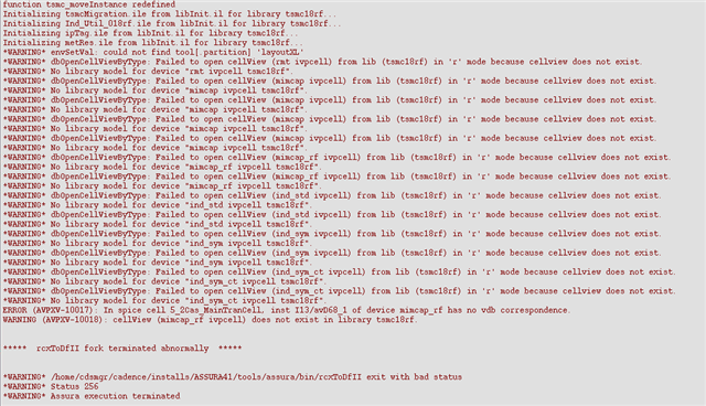

    Omar Alngar over 6 years ago in reply to Andrew Beckett
    I thinks this is the main problem as the following screenshoot
    So, How I can find this Cell view? or what is the meaning of it?
    Andrew Beckett over 6 years ago in reply to Omar Alngar
    This is needed to place the instance in the extracted view. It's usually a scaled version of the symbol view with special behaviour to show the dimensions of the recognition layer. You probably should check with the PDK provider, but if there's a mimcap_rf symbol in the library, you can probably just create a file with this content:

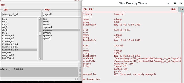

    the ivpcell for this capacitor is already exist as follows
    However, the program always told me that " failed to open this cellview in 'r' mode because this cellview is not exist, as shown in the previously mentioned log file at the 1st comment.
    the log file gives an error just above the previously mentioned warning as follows
    The cellView does not exist. In the log file it is looking for mimcap_rf whereas the library manager you are showing mimcap_rf_m6 (i.e. with _m6 on the end). It seems that the mapping in the extracted view generation is set up to use mimcap_rf not mimcap_rf_m6. I don't have access to a current version of this PDK, so can't pinpoint exactly where the error is (might be in the file lvsfile). It would be best to contact the foundry about this discrepancy...
