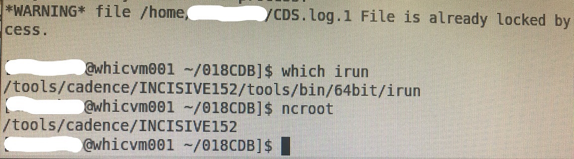

    Andrew Beckett over 6 years ago in reply to chofie
    It would help if you shared what the results of the "which irun" was - that might help me spot what was wrong.
    Also, what does running the command "ncroot" at the UNIX command line return?
  • chofie
    chofie over 6 years ago in reply to Andrew Beckett
    It appears that your UNIX path is set up incorrectly (so it's not an installation issue, nor is it a wrapper script that is being used). It shouldn't directly include the bin/64bit directory - instead you should include the bin directory. So, dependent on whether you use csh or bash/ksh it would be:
    set path = (/tools/cadence/INCISIVE152/tools/bin $path)
    or
    export PATH=/tools/cadence/INCISIVE152/tools/bin:$PATH
    Then whether you want the 64-bit version of incisive can be controlled using the $CDS_AUTO_64BIT env var, or using the "Run with 64-Bit Binary" switch on the Setup->Environment form in ADE. If you just want everything to run in 64-bit mode, you can just do:
    setenv CDS_AUTO_64BIT ALL
    or
    export CDS_AUTO_64BIT=ALL
  • chofie
    It completely works now.
    Thank you so much for help, Andrew.
