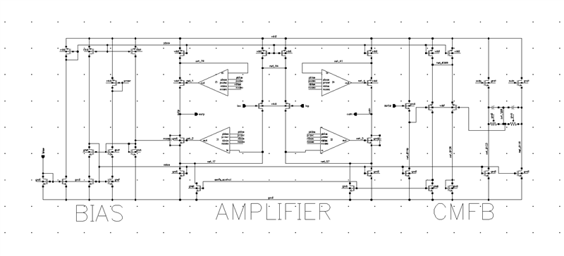

I am trying to print my circuit schematic view, the circuit is not that big, its like fully differential amplifier with biasing circuit.
I tried to print the schematic by using three methods but non of them is giving me a clear result that I can use the picturer in formal writing or presentation
method1. using export image
method2. using export HTML from ADEXL
method3. using "print" command
Do Cadence suggest to use third part software for plot ?
Thank you

    NorNand over 6 years ago
    may be I can show you part of the circuit, still not clear, I cant read transistors information from the image

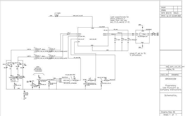

    If you use the Save Image form and increase the resolution:
    Then the picture can improve from this:

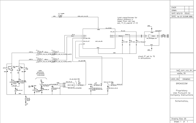

    To this with 4x resolution increase (you may need to click on it):
    To this with 16x resolution (the problem here is that the lines are pretty thin and so they appear faint at normal resolutions):
    What you really want for documents is a vector format rather than a raster format - the standard way used to be to use the Print mechanism to produce EPS (Encapsulated PostScript), but unfortunately Microsoft dropped support for that. There's a request for SVG output from Virtuoso (this exists for waveforms, but not for schematic or layout), but it's not been implemented yet (there are some infrastructure optimisation reasons why it's difficult). Might be a good idea to contact customer support to add another request to the list of others asking for this (it all helps with prioritisation).

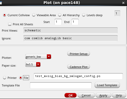

    The method I’ve been using, which appears to provide very clear results, relies on printing the schematic in Postscript format and then converting it to a portable network graphics file. This for type can be used in Microsoft applications and preserves the resolution. These are the steps I follow:
    1. In my .cdsplotinit file in my $HOME directory, I define a black and white generic Postcript plotter as follows:
    generic_bw|Postscript printer: \
            :manufacturer=Adobe: \
            :type=epsfi: \
            :spool=lp -d agrprt270dup: \
            :maximumPages#1: \
            :resolution#300: \
            :paperSize="9x5.5" 2700 1650:
    2. From the Virtuoso schematic File-> Print command, I set the options shown below in its GUI to plot the schematic to a file in my cadence working directory. Note that the plotter I specify is “generic_bw” which I define in step 1.

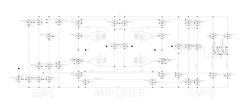

    3. From the cadence working directory at its UNIX prompt, I use the following script to convert the Postscript file to a Portable Network Graphic file “.png”. The script relies on a version of Ghostscript on your system in your UNIX path. Optionally, the script calls Imagemagick to trim the white space from the file. If you do not have that installed in your UNIX environment, you may comment out that line.
    —————————————— start of script —————————
    gs -dSAFER -dBATCH -dNOPAUSE -r600 -dEPSFitPage -sDEVICE=pngmono -dTextAlphaBits=4 -dDEVICEWIDTHPOINTS=648 -dDEVICEHEIGHTPOINTS=396 -sOutputFile=$1.png  $1.ps
    # Optional - may distort image
    echo "Done, png and trimmed file are \"$1.png\" \"$1_trimmed.png\"."
    —————————————— end of script —————————
    An example is attached of a .png file created using this method. I hope this helps and at least provides an alternative!
