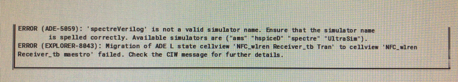

    I tried to use Cellview Options to open this state and, fortunately, it works.
    I also tried to use ADE Explorer to open this state by creating maestro firstly.
    The Error in CIW is showing below indicating there is no spectreVerilog simulator.
    Then I tried again, and it shows:
    *Error* error: Cannot find a setup database entry for handle 0. -nil
    Thus, the only way now I can open spectreVerilog is to use Cellview Options rather than using Directory Options.

    Andrew Beckett over 6 years ago in reply to chofie
    First of all, are you sure that the state directory actually exists? It will not show spectreVerilog as a choice for simulator if there is no state with that name.
    So try doing:
    ls ~/.artist_states/NFC_wiren/Receiver_tb
    My guess is that you don't have any states in that directory that you can load.
    Secondly, if you just try to take an existing spectreVerilog state cellView and try to do a "Open with" ADE Explorer, then it will (of course) produce the error you show - it would try to keep the same simulator, and since that's not supported, you'll get an error. What I was suggesting was to create a new maestro view for the test bench and then do a Setup->Load State within that to load the spectreVerilog state cellView (just as you managed to do with ADE L).
    Anyway, it sounds as if you have a way forward by loading cellView states.
