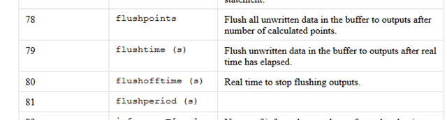

I'm having a problem where I cannot plot any signals in a spectre transient sim until it is complete. This is a long sim, so I want to make sure things are correct along the way. I've tried using the graph button, calculator, and direct plot with no luck. I also typed "results()" into the CIW window and the output is only "trans(variables)"
It seems like the data is being stored somewhere other than the specified path. Typically I see a psf file in "/testbench/spectre/config/distributed/jobname/psf" while the sim is running, but this folder is empty. Opening this path in a terminal or in results browser both show nothing.

    1. Have you navigated in UNIX to the psf directory to see if there is a "spectre.out" file - or are you just trying to locate it with the Results Browser?
    2. Have you examined or changed any of your flushtime parameters? These parameters detail how often the data is written to disk. The more freuqently it is is written, the greater the overall simulation time. These options are under the "Options->Output tab" of the transient analysis and are documented at URL:
    https://support.cadence.com/apex/techpubDocViewerPage?xmlName=spectreref.xml&title=Spectre%20Circuit%20Simulator%20Reference%20--%20Analysis%20Statements%20-%20Transient%20Analysis%20(tran)&hash=pgfId-1063371&c_version=19.1&path=spectreref/spectreref19.1/chap3.html#pgfId-1063371
    or as shown below.
    Shawn

    All of the flush parameters parameters in the output tab were blank, but I did finally see results after setting CDS_PSFXL_FLUSH_INTERVAL to 300. I think this is default, but I guess it must have forced a flush. I'll mess around with these a bit more, but I think this will fix my problem, thank you for the suggestion.

    Note that the flushpoints/flushtime/flushperiod parameters of a tran analysis don't help with PSF XL, you need to use the UNIX env vars that Shawn mentioned. However, I would caution against setting CDS_PSFXL_FLUSH_INTERVAL and CDS_PSFXL_MAX_FLUSH_INTERVAL so low, as if they are set very low, it limits the chunk size of the data that is written, which compromises read performance (that's one of the performance gains that PSF XL offers). I understand why you might want to have the flush interval lower, particularly near the beginning if a simulation to make sure it's starting OK, but if the simulation is taking hours, then after it's up and running, there's not so much need to see immediate feedback every 10 seconds. So that's why the CDS_PSFXL_INIT_FLUSH_INTERVAL is more reasonable to set, to allow initial quick updates, but then that increases over time so that you get the read-performance gains of bigger chunks being saved.
