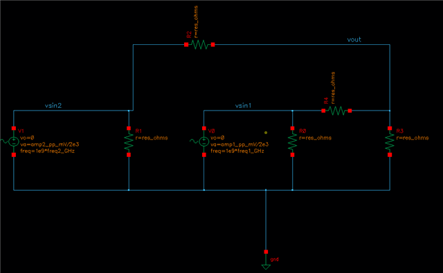

    First, recall that in general the dft() function is complex, so indeed if you just want the magnitude at a specific frequency, you can use the value() function. The first argument is the dft() function and the second is the input frequency. The value function provides an option to interpolate or round down the second entry when it evaluates the first argument (see its arguments in Figure 1).
    However, to prevent spectral leakage, where your amplitude may "spill" over into more than one bin, you need to specify an exact number periods of the input frequency for the dft() time period. Otherwise, depending on the windowing method you choose for the dft(), you will observe that the amplitude of your input frequency will occupy multiple frequency bins.
    In addition, depending on the accuracy you need, you may need to use the transient analysis option "strobeperiod" to set the output time points to the exact times required by the dft(). For example, if you are doing a 32768 point dft() over 32.768 ns, set the strobeperiod to 32.768 ns/32,768. This avoids the need for the dft() to interpolate the values at the times you specify.
    An example of the dft() is shown below in Figure 1 of two summed tones at node vout at frequencies of 5 GHz and 10/3 GHz with amplitudes of 500 mVpp and 200 mVpp  respectively. The two sine waves are summed through a passive summer (see Figure 2, res_ohms = 50). The dft is performed over an integral number of 5 GHz periods and its amplitude all falls into one frequency bin. Its single-bin amplitude is shown as about 84 mV.  However, there are not an integral number of periods of the 10/3 GHz sine wave and its amplitude is not contained in a single bin. Hence, in your case where you apply an single input frequency (that may produce intemods in your circuit), the time interval for the dft() should correspond to an integral number of periods as you sweep the input frequency. Further, the frequency of any intermodulation products your circuit produce will likely not contain an integral number of periods for the dft() analysis period. Hence, some of their power may spill over into your main frequency bin - resulting in some error.

    Figure 2

    Dear pepijndevos,
    ➢ Can I use the ADE-L variables directly in the calculatorsomehow?
    Yes. A design variable can be included in a Calculator expression (or an ADE-L/ADE-XL/Assembler expression) by referring to the variable as a text string in the VAR() function. In the example I described, the end time of my simulation was defined as a variable “tstop” that is set to 100/(1e9*freq1_GHz). freq1_GHz is a variable that defines one of the two frequencies I used in the passive summer. I performed a series of simulations where I varied freq1_GHz from 0.1 to 10 and plotted the value() function as a function of freq1_GHz and attached the result. In my dft() expression, I used the period of freq1_GHz to set the dft analysis to 40 periods to avoid spectral leakage. I think this is similar to what you were attempting to simulate. If it helps, I’ve attached a comma separated file of ADE-L outputs that you can import into ADE-L or just copy either of the expressions into ADE-XL/Assembler. Let me know if I’ve managed to confuse you or if you have any questions.
    Shawn
