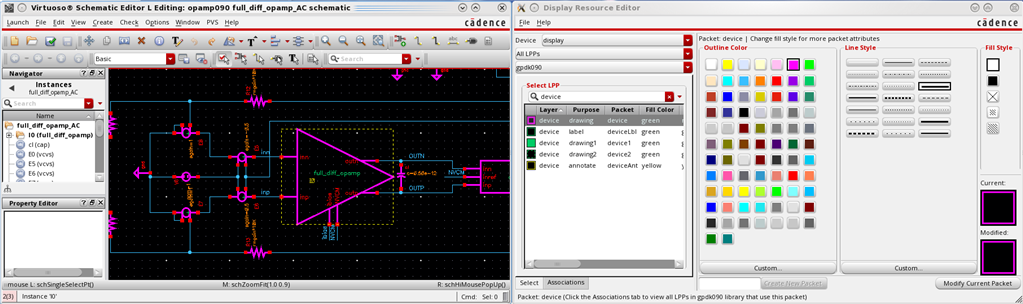

How can I change the thickness, color of components from libraries like analogLib?
I tried to follow this guideline by changing device_drawing1 from Display Resource Manager but it doesn't work.
My Cadence tool version is different though. It's version IC6.1.8-64b.500.8.
I tried all different combination of All LPPs, All Packets, All Valide LPPs and still doesn't work.
Does anyone know how to do that?
    The tutorial isn't quite right. Firstly you need to pick the library for the technology library your own schematic is associated with (if you attached your library to a particular technology library, it's that). In other words, if you go over your design library in the library manager, and Right Mouse->Properties, you should see techLibName set to something (probably), in which case use that name.
    Then search in that library for "All LPPs" and search for device. The component outlines are device/drawing and not device/drawing1. device/drawing1 is only used for filled shapes (in the symbol editor, if you use Create->Shape->Rect and then on the F3 options form there's a choice of outline or filled - picking filled will use the drawing1 purpose).
    Details on what layer-purposes are used by the schematic editor can be found in <ICinstDir>/doc/comphelp/comphelp.pdf - search for "Customizing Schematic Object Attributes".
    As you can see, this worked:

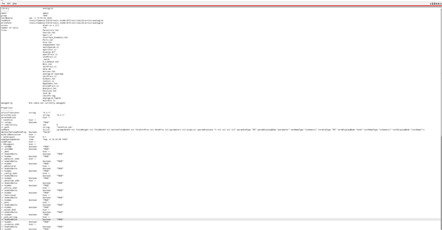

    Thank you very much. You also talked about another problem I'm facing with symbol too.  First, I couldn't find the  techLibName anywhere. Here is the result of Right Mouse->Properties for analogLib library.
    Then I tried  "All LPPs" and search for device and change for all libraries in the third Technology Library Name but it doesn't work.

    Andrew Beckett over 6 years ago in reply to BaaB
    It wasn't the "analogLib" library I was suggesting you to use, but the technology library associated with the schematic that you're instantiating the analogLib components in. analogLib has its own technology database (which is why it shows up as one of the choices in the Display Resource Manager). Provided that the packet names are consistent between analogLib and whatever technology you're using (some foundries change them, for reasons I've never understood) then it doesn't matter which you've changed.
    What "doesn't work"? What does the Display Resource Manager look like?
    There is no thickness choice in the Create->Shape commands. The thickness of the lines comes from the definition of the packet in the display resources setup, and is not a property of the database. Lines in the database are zero-width, and rectangles are an area - the outline width is a display property.
    Perhaps you should contact customer support so we can have a screen sharing session with  you to walk you through this, because this ought to be pretty simple to change.
