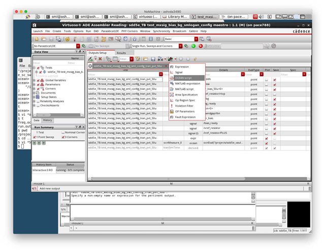

    Have you tried to include it as an output in Assembler or Explorer? In this fashion , it will be executed for each corner as it completes. Figure 1 shows how to include an ocean script as an output.
    Shawn
    Figure 1

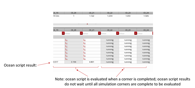

    I just did an experiment with a smaller circuit and ran it over corners with a simulation stop time that is dependent on a variable in the set of corner simulations. I used an ocean script that computes the time of the simulation and reports it as an output for each corner. I found that the ocean script is evaluated after each individual corner is completed. Figure 1 shows the outputs tab of the Assembler session showing the ocean script result for completed corners while additional corners are still in their simulation phase.
    Are you using Assembler?
    Shawn
    Figure 1

    I am running in ADE assembler and here is what I see.
    Only at the end can i refresh and get the calculations
    This is also true with outputs defined as expressions
