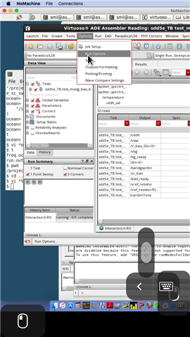

I have started a long transient simulation running with 10 jobs. While this simulation is running, I want to start another quick DC simulation out of the same Maestro-test.
I tried to increase the max. jobs from 10 to 12 via the "Job options" ("start immediately" is checked) and expected to get 2 more jobs for the DC simulation.
But that is not working. The DC simulation is in "pending" state.
How can I start another simulation next to the already started simulation ?

    Dear HoWei,
    This may be a silly question, but have you set the simulation sets to run in parallel in lieu of in series? If they are set to run in series, then the behavior you are observing is exactly how Assembler or Explorer will behave when a second simulation set is submitted and the first set is still running.
    To change the simulation option to “parallel”, under the menu item Run->Options, as shown in Figure 1, the resulting panel, shown in Figure 2, allows you to select the “parallel” option.
    Shawn

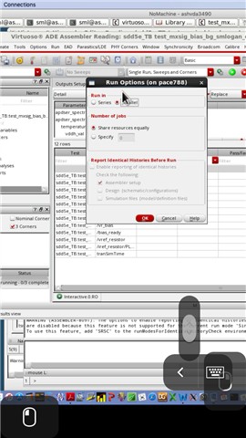

    Dear HoWei,
    To change the simulation option to “parallel”, under the menu item Options->Run Options, as shown in Figure 1, the resulting panel, shown in Figure 2, allows you to select the “parallel” option.
    Shawn
    Figure 1
    Figure 2
    Andrew Beckett over 6 years ago in reply to ShawnLogan
    Shawn,
    You beat me to it. I would say that if you pick "parallel" mode, it's a very wise idea to make sure that in your job policy settings, at the bottom, you have the Multiple Runs section set to Wait until currently running points complete. Otherwise adding new jobs has this irritating (I think very bad) way of killing existing jobs sometimes and fairly sharing amongst the new requests.
    Note too that the new "LSCS" mode in the job policy that was introduced in later IC618/ICADVM181 versions will also allow spare capacity to be used for new jobs even if you're in series mode, and also doesn't have this evil Reassign immediately for new run choice for multiple runs.
