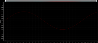

I am working on a filter, making simulations in Virtuoso . My transient response is a sine signal and it has an offset about -32mV . I would like to move that offset to 0V by calcultor
This is my response
    Andrew Beckett over 6 years ago +1
    Just add 32m to the signal in the calculator. If your signal is VT("/out") say, then plot VT("/out")+32m . Perhaps I'm missing something because this seems rather obvious... Andrew.

    VictorArzate over 6 years ago in reply to Andrew Beckett
    Thank you very much, Andrew. In fact, what I didn't know was how to write the commands on the calculator. Your example was very helpful. I already tried it and it worked.
