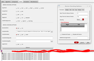

    Also, coming to approach 2 to find max voltage (lets say Vgs with this model), where does  mychecks.scs (i/p file which has the the checks to perform) go ?
    You mentioned the checklimitfile area is where i give pointer to the o/p file I want to write to. How the the flow pick this input file ?
    Andrew Beckett over 6 years ago in reply to npamd
    For the second approach, you could also write the asserts like this:
    vdbAssert assert primitive=bsimcmg expr=max(v(d)-v(e)) info=yes level=notice
    vgbAssert assert primitive=bsimcmg expr=max(v(g)-v(e)) info=yes level=notice
    which would give you what you want. The d, g and e are in terms of the terminal names for the primitive device.
    The mychecks.scs file can be placed anywhere - you simply need to ensure it's included in the simulation. I originally wrote how to do this, but my first attempt at a reply discarded what I said, and I omitted it the second time by mistake. Use Setup->Model Libraries or Setup->Simulation Files and use the Definition Files field to reference the file (the second is better if you have corners set up in ADE XL/Explorer/Assembler).
    I assume your second question is just repeating the first? Otherwise I don't understand what you're asking.

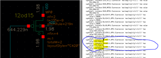

    Andrew, Thanks for your response..! However there are cpl of things I wanted to check upon:
    1. The checks seem to not do the intended thing (see highlighted below). This PFET experienced a VGS of ~1.98 V during a tran sim (annotated). However, the check told me that the max Vgs the same PFET saw during the sim period was ~723 m.
    My check :
    vgsAssert assert primitive=tmibsimcmg expr=max(mag(v(g)-v(s))) info=yes level=notice
    Assuming I get this part right, next questions:
    2. How can I only report devices in violation ? Lets say, my design targets are:
    Vgs, Vds, Vgd: 1.5V
    Vdb,Vsb,Vgb: 2V
    How can I apply filters to report devices that violate these limits, at any instant in the tran simulation window ?
    3. The checks seem to be missing FETs in my design. There is a block in my TB of which I instantiating 10 copies. However, the checks are completely missing 8/10 instances (and all devices in them). Why would this be ?
    This is what my setup looks like currently:
    I would suggest you contact customer support - I'm sure this is explainable, but almost certainly we need to see the data to understand. Otherwise it would need a lot of guess work.
    Some quick answers though:
    1. Not sure why this would be. Hence the need to contact customer support
    2. This is the primary purpose of assert statements. In this case we're using max to give the maximum overall, but if you omitted the max()  and used the min and max parameters of assert, you can get it to flag when anything goes out of bounds. See "spectre -h assert" or look at the spectre asserts RAK on support.cadence.com
    3. This may be because you're running Spectre APS? This will combine parallel devices into an m-factor, and hence reduce the number of actual devices in the circuit (which is good for speed). That's a guess though - again, needs customer support input.
