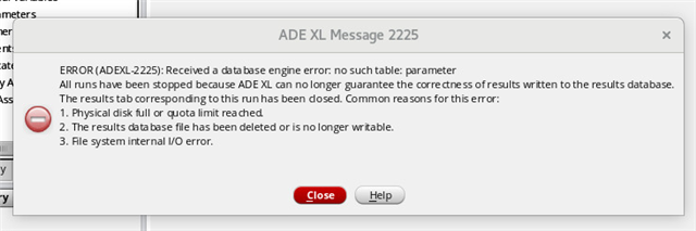

I want to run a Monte-Carlo stimulation, but I get the error 'database disk image is malformed'. How can I solve this error?

    vvdb over 6 years ago in reply to Andrew Beckett
    1. I'm using Virtuoso Analog Design Environment
    2. version IC 6.1.7 - 64b.500.15
    3. ADE XL
    4. yes, I still have enough quota
    5. see picture
    Andrew Beckett over 6 years ago in reply to vvdb
    If there's no more information in the CIW, all I can suggest is that you try a more recent version - I know there have been a bunch of robustness improvements related to the handling of the "RDB", so checking in the latest IC618 (ISR12) would make sense.
    Other than that, all I can suggest is that you contact customer support. This normally only seemed to happen when the disk filled up (bear in mind that this is typically where the design library is stored, not where the simulation directory is) - these might be on different volumes as often simulation data is transitory and so people allow more space.
