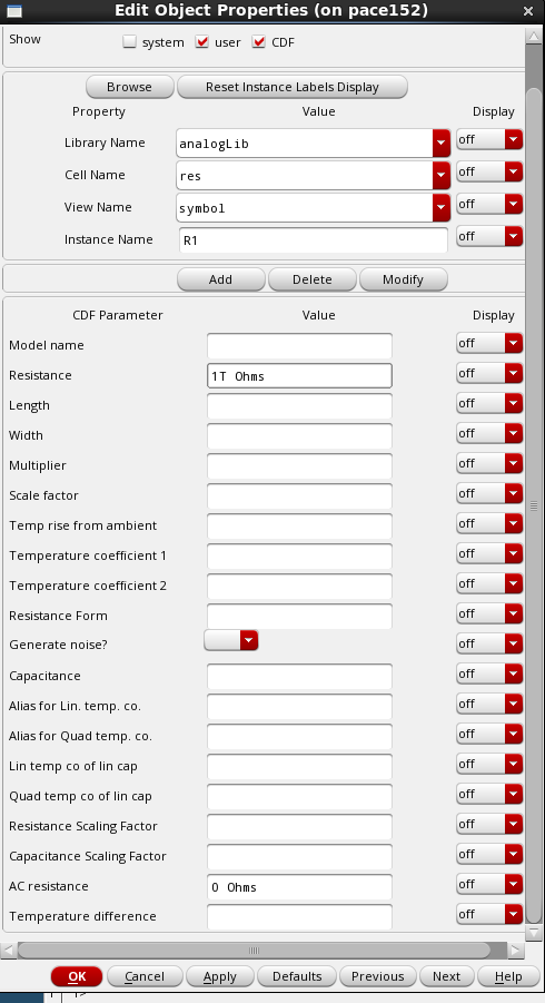

    Thank you Shawn. I am mostly interested in DC gain contribution by first stage and second stage. Is there a way to find out from stb sim? One way I can think of is breaking the loop with an inductor and running ac simulations. Not sure if there is a better way.
    I don't know the specific circuit topology you are using - is your feedback signal AC only? In other words, will the DC operating point be stable if you break the loop? If so, you might consider the use of an AC resistor in lieu of an inductor when you break the loop. Since you will need a large inductance value, this can cause simulator/spectre issues. The analogLib AC resistor allows you to set a 0 DC value and very large AC value.
