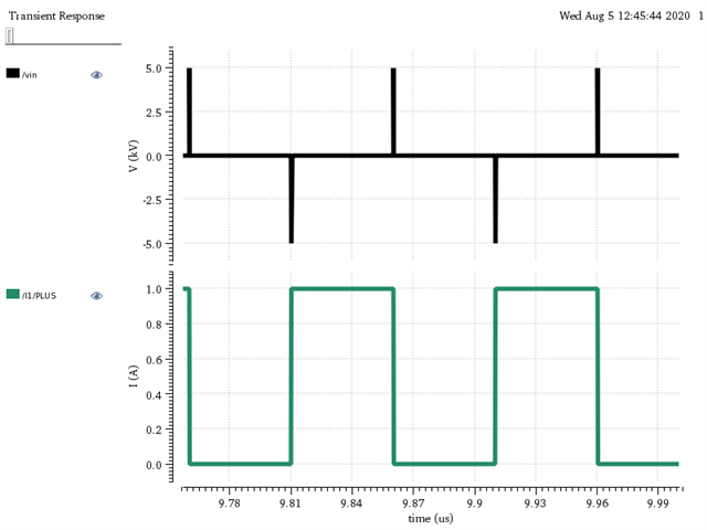

  • jehh
    jehh over 6 years ago in reply to Frank Wiedmann
    Thank you - this seems like the right path.
    However, I try to specify lshort=10n, under additional arguments in the spectre simulator options, and then run a transient simulation. However, it doens't seem to short the inductor. Am I using the lshort correctly, or did I misinterpret?

  • Frank Wiedmann
    Frank Wiedmann over 6 years ago in reply to jehh
    In earlier versions of Spectre, the option was named lcut instead of lshort. You can check with "spectre -h options" if this is the case.

  • jehh
    jehh over 6 years ago in reply to Andrew Beckett
    Hi Andrew,
    I am using spectre_17.1-ISR14_64 (also, lshort does show up, when I look type "spectre -h"). The only mention of lshort in the log file, is under global options sections, see setion below >

    And the input.scs netlist is very simple, but still contain the inductor >

    L0 (vout vin) inductor l=1u
    C0 (vout 0) capacitor c=1u
    R0 (vout 0) resistor r=1K
    I1 (vin 0) isource type=pulse val0=0 val1=1 period=1/fs delay=10n \
            rise=200p fall=200p width=0.5/fs
    simulatorOptions options psfversion="1.4.0" reltol=1e-3 vabstol=1e-6 \
        iabstol=1e-12 temp=27 tnom=27 scalem=1.0 scale=1.0 gmin=1e-12 rforce=1 \
        maxnotes=5 maxwarns=5 digits=5 cols=80 pivrel=1e-3 \
        sensfile="../psf/sens.output" checklimitdest=psf lshort=20u
    tran tran stop=10u errpreset=conservative write="spectre.ic" \
        writefinal="spectre.fc" annotate=status maxiters=5
    save I1:sink L0:1 C0:1 R0:1
    Is there any obvious thing I am doing wrong?

  • Frank Wiedmann
    Of course the inductor still appears in the netlist, this option does not change the behavior of the netlister, after all. However, the inductor should behave like a short in the simulation (which you would see in the simulation results). If the option is listed in the log file (as in your case), it is supposed to work.
  • jehh
    Hi Frank,
    Sorry if I seem like a young buck. ;) Below I tried to insert the simulation result. I am pulsing a current through an inductor, at node /vin - this node is seen to spike at several kV, unexpected with the inductor shorted.
    If you have any suggestion on how to investigate further, they are very welcome.
    BR,
    JEHH
  • jehh
    jehh over 6 years ago in reply to jehh
    Andrew Beckett over 6 years ago in reply to jehh
    Please contact customer support. I did some experiments, and in SPECTRE16.1 versions the lshort appears to work with this example, but in later versions it doesn't. The inductor is still listed in the circuit inventory (which may be OK), but I still see the behaviour of the inductor present in the circuit.
