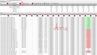

Dear Here,
I am using virtuoso6.1.7.  I had a simulation job running with adexl on for days. Then at a certain moment, virtuoso was frozen due to some operation. At the end, we had to kill the virtuoso. But the simulation job was not killed and managed to finish on the server.
So if I use result browser, all of my data are there.  But when I restart the adexl, I see the job status is " running" , which in fact is finished. If I click the re-evaluted button, the result cannot be reevaluate and the job status is the same.
As the screenshot shows,  my job was running like this. After adex was killed, my simulation was still running on the server till finished. Then I reopen the adexl section, and if I click "view results", it shows the same as it was frozen. And if I click reevaluate, it doesnot really reevaluate.   Does anyone know how to reevaluate in such case? Using the data to evaluate the expression is very important in this case.

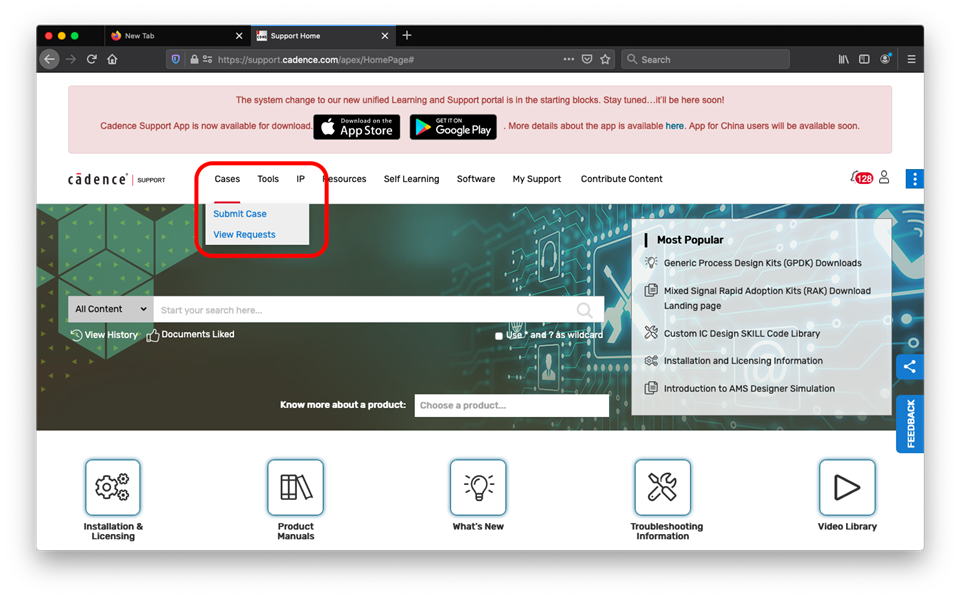

    Andrew Beckett over 5 years ago in reply to kerong
    I already put the link in my first suggestion to use customer support (I just didn't in the reply a couple of hours ago because I was doing that on my phone), but here it is again: http://support.cadence.com
  • kerong
    kerong over 5 years ago in reply to Andrew Beckett
    Hi Andrew, Sorry for the stupid question. I am in the customer support site, then who I shall contact with? Or I shall repeat my question somewhere?
    Having logged in, go to Cases->Submit Case and enter the description of the product and problem there - you can always include a reference to this thread as a URL to help guide the application engineer. Here's where it is on the page:
