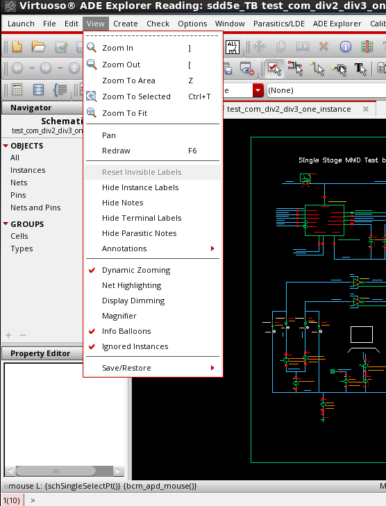

    You really shouldn't have to open the debug environment. You should be able to annotate the results using the context menu (right mouse button menu typically) over the output for one of the points (e.g. over the nominal column, or over the column for the corner, in the row with one of the outputs) and choose to annotate from there. If using "info balloons" for annotation, you can even annotate multiple corners at once, and as you hover over devices, it will show an info balloon with the operating point values for that device from the corners you've chosen.
    If I'd been working today/tomorrow, I'd have captured a screen grab to show you what i meant, but hopefully this is clear enough.

    Dear Andrew and Pecman,
    Thank you, Andrew, as always, for your insight!
    i believe Andrew is suggesting to enable Info balloons as shown in the following Virtuoso menu item. Hovering over a trace will show the simulation data in a small window (see second attachment). In my case, I only have transient data and hence waveforms are displayed.
    I hope this helps!
    Shawn
  • Pecman
    Pecman over 5 years ago in reply to ShawnLogan
    Wawoo!
    That is pretty cool!
