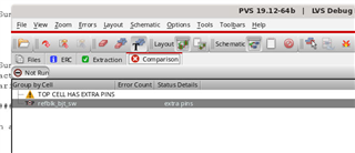

    Hi Andrew,
    by original file, will get lvs result like below:
    we have extra pins.
    after add this command

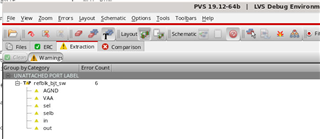

    layer_def m1_textt 1098; // layer def ME1 1098
    layer_map 46 -texttype 0 1098; // layer_map 46-datatype 0 1098
    text_layer m1_textt;
    port -text_layer m1_textt;
    attach m1_textt ME1;
     now lvs result like below:
    now lvs show unattached label,
    I think I do wrong with my attach command.
    please advice.
