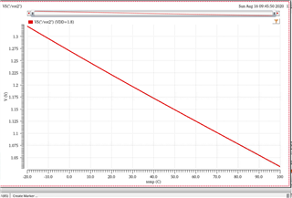

    I read the documentation on viva. I couldn't figure out how to keep the horizontal axis to temperature.
    Here is the plot of VS("/vot2").

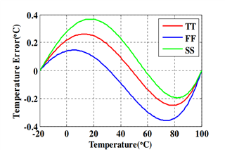

    I would like to plot the deviation of temperature with respect to temperature to determine the temperature error.
    The temperature sensor’s INL is then the maximum absolute value of the temperature error over the temperature range determined by the two ending-points fit line.

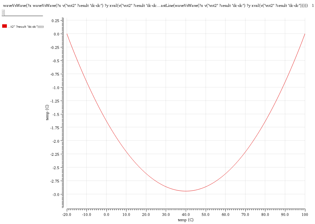

    Maybe something like this:
    waveVsWave(?x waveVsWave(?x VS("/vot2") ?y xval(VS("/vot2")))  ?y waveVsWave(?x VS("/vot2") ?y xval(VS("/vot2")))-abFirstLastLine(waveVsWave(?x VS("/vot2") ?y xval(VS("/vot2")))))
    For my made up example, this came up with this curve:
    This is using abFirstLastLine from this post. Bit of converting back and forth to change the x-axis, but hopefully it makes some kind of sense.

    I have one question. Is it possible to get the temperature deviation from 0? As shown in the following example.
    Integral Nonlinearity Error (INL) error based upon an end-point
    fit line over the temperature range of [-20
    C, 100C] In the attached plot, over the temperature range of -20C to 100C, the  temperature error
    is bounded within ±0.4
    C over process corners.

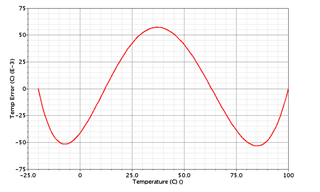

    Thank you for your response. What want to plot is the INL temperature error. A waveform that looks like this:
    Andrew has posted a linear regression function that may be used for this purpose. So you mean to use something like this:

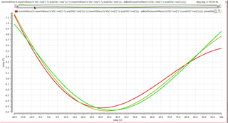

    waveVsWave(?x waveVsWave(?x VS("/vot2") ?y xval(VS("/vot2"))) ?y (waveVsWave(?x VS("/vot2") ?y xval(VS("/vot2"))) - abBestFit(waveVsWave(?x VS("/vot2") ?y xval(VS("/vot2"))))))
    I changed the bFirstLastLine  to abBestFit and got somethig that looks like this:

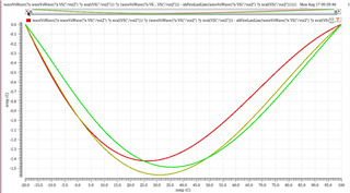

    I did the simulation-based the calculation you provided which goes like this:
    (waveVsWave(?x waveVsWave(?x VS("/vot2") ?y xval(VS("/vot2"))) ?y (waveVsWave(?x VS("/vot2") ?y xval(VS("/vot2"))) - abBestFit(waveVsWave(?x VS("/vot2") ?y xval(VS("/vot2")))))) - (0.5 * (ymax(waveVsWave(?x waveVsWave(?x VS("/vot2") ?y xval(VS("/vot2"))) ?y (waveVsWave(?x VS("/vot2") ?y xval(VS("/vot2"))) - abBestFit(waveVsWave(?x VS("/vot2") ?y xval(VS("/vot2"))))))) + ymin(waveVsWave(?x waveVsWave(?x VS("/vot2") ?y xval(VS("/vot2"))) ?y (waveVsWave(?x VS("/vot2") ?y xval(VS("/vot2"))) - abBestFit(waveVsWave(?x VS("/vot2") ?y xval(VS("/vot2"))))))))))
    And I get the attached plot which is not quite as I expected.
    Can you let me know if we are missing anything?

    Maybe I did not understand what your intentions were? However, to me, the plot appears totally consistent with what I expected. For each of the three cases you have plotted (yellowfins, red, and green), the peak positive and peak negative magnitudes of each respective curve have the same absolute values over the -20C to +100C range. For example, the green peak positive value is about +780 and its peak negative value is about -780 (I'm not sure of the y-axis units...milli LSB?). In my prior post, I included the following "
    Unknown said:
    I think, instead, you might want the plot to have symmetrical maximum and minimum INL values for each curve in order that you might easily compare the maximum INL value each case provides.
    It appears to me this is exactly what the curve fits provide. Let me know if I misunderstood your actual intent.
