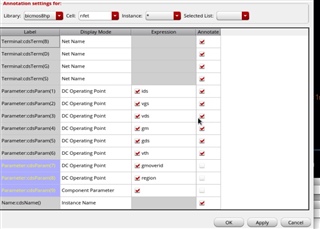

I followed the instruction by going to CIW > Tools > CDF > Edit and did the following:
1. Scope selected cell
2. CDF Layer selected Base
3. Library Name the desired library is chosen
4. Cell Name the preferred Cell name is selected
5. I am confused on callback setup
6. From the tab, I chose Interpreted Labels
7. Use CDS parm to display selected operating point results and added region
I am attaching two pictures. The first one is what I get on the annotation balloon and the second picture is what I did to select the region dc parameter. But for some reason, region is not showing on the transistors.
I consulted the PDK documentation, and I couldn't find anything.
Thank you so much for your help.
