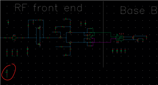

I get confused recently. I am simulating a DCR (Direct conversion receiver) to get the output DC term caused by second order non-linearity of it. And I find a weird phenomenon, that is the vpulse can influence the simulaition result even if it only connects to ground. I change the frequency of it, and the simulation results changed. Is it a BUG? or something impossible?

    This is my circuit. I used vcvs to model VGA, its' output is above 100 V. while the difference between the two branch is less than one hundred millivolts.

    Hi Andrew
    Thanks for your help. Your analysis helped me find out the cause of the different simulation results. I think it is the time step and tolerance, cause I get a "good looking" result when I use conservative. And before that no matter whether I change the rise time, fall time or period of the vpulse, the result remains the same. So the vpulse is not the source of different results I got before.
