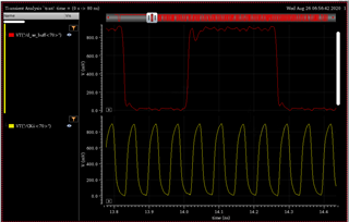

In my simulation, the D input to the flop consists of random data.  I would like to measure the time between each transition of data to the capturing clock edge.  It is not hard to trigger on the crossings for data but I have a hard time to set the stop time as the subsequent clock edge.  I have tried as many variants of the Delay function that I can think of but none seem to work.
Here are example waveforms.  The goal is to find the minimum set up time for a long sequence of events.

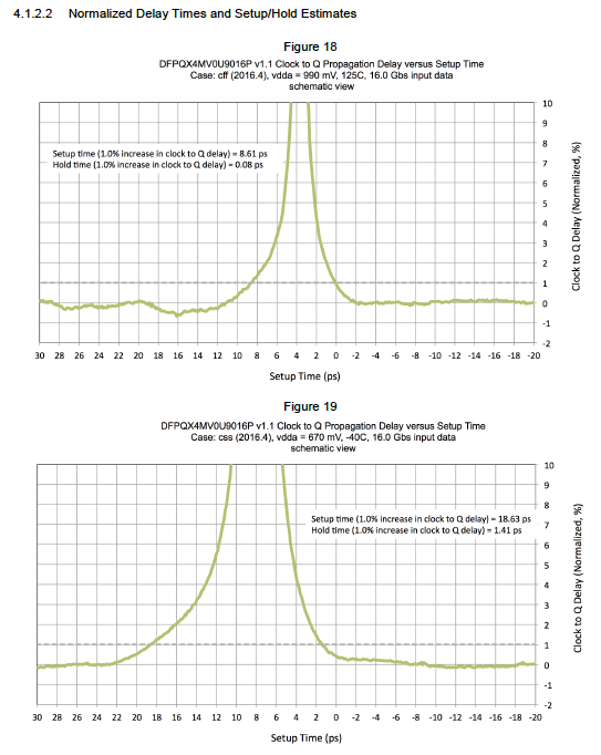

    The method you have chosen to characterize set-up time is a bit non-conventional. The method used in the industry commonly is one that measures the propagation delay time and examines its magnitude as the delay between the input data and clock is varied. When the propagation delay increases by a threshold (usually 1% or a few percent) from its value when the clock and data are not in close proximity, the time is classified as  a "setup" or "hold" time. I've illustrated an example from an analysis I did some time ago.
    In the method you are planning to study, you will not get a quantitative view as to how close the minimum time you measure is to the actually minimum setup time - if my comment makes any sense.

    If you locate a given data transition time, I might suggest you use the cross() function on a clipped version of the clock signal to measure the first clock edge after a given data transition. Specifically, the algorithm might be:
    1. Locate a data transition, Tdata.
    2. Clip the clock signal between Tdata and the end of the simulaiton and define the clipped signal as clock_clipped
    3. Locatie the first clock transition of the signal clock_clipped using the cross() function where the crossing incident corresponds to 1 and the direction of the transition corresponds to whether the DFF samples on the clock riisng or falling edge;  define its value as clock_clipped_sampling_transition_1
    4. Take the time difference (clock_clipped_sampling_transition_1 - Tdata); this corresponds to the time difference between the data edge Tdata and the next sampling clock edge
    I hope I understood your question and this helps you out...

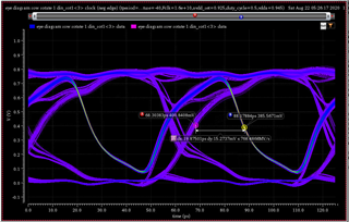

    Thanks for the thoughtful response.  I have already characterized the minimum set up time for my flops in a similar fashion.  The problem at hand is to see how much margin exists for a given operating condition.  How would you apply your method to a random stream of data where the data to clock time varies?  Currently, I plot eye diagrams and use a delta cursor to measure the minimum time between a data transition and subsequent clock edge.  I'm looking to automate this manual measurement.

    I have not used ocean scripting much in my career.  I was hoping to using the existing "delay" function in the calculator to create a set of data to clock delays that I could then query for the minimum value.  I have tried to get this to work with my Cadence application engineer but without success.  In my application, I have hundreds of flops and my sim runs about a thousand random bits of data through them.
    Another approach would be to use the eye diagram functions (eyeAperture, eyeDiagram, eyeHeight, eyeWidth) to do what I am doing manually now.  This involves finding the eyeWidth between data and clock transitions.  Can you think of a way to apply those functions here?  It seems that if I can do it manually, that it should be automatable.
