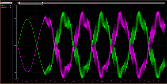

Dear all,
I encountered an unexpected ringing while running transient simulation for a high-speed receiver.
I am using ADE Assembler and the version is ICADV12.3-64b.
The detail is as following,
There are CTLE, source follower, interleaving switch and SAR ADC in series in my test bench. The differential input of CTLE is proved by an ideal voltage source through 50Ohm ideal resistor.  And there are also 8 "vpulse" voltage source realizing 8 phase 8GHz clock driving interleaving switches. There is some s-parameter file to model the induction inside CTLE. And there are a few tens of ideal voltage sources providing dc control signals. I saw unexpected ringing on top of the CTLE input signal in the transient waveform.
In order to debug this issue, I remove all circuitry after the source follower. So there are only input voltage source, CTLE, source follower and 8 clock voltage sources (which are open), and some dc control voltage source in the test bench. The ringing remained there.
If I removed those 8 clock voltage sources in the schematic, or did not save their waveform , the ringing went away.
Below is the my transient simulation setup parameters
start = 0 s
outputstart = 0 s
stop = 10 ns
step = 10 ps
maxstep = 200 ps
ic = all
useprevic = no
skipdc = no
reltol = 1e-03
abstol(V) = 1 uV
abstol(I) = 1 pA
abstol(U) = 1 u
temp = 27 C
tnom = 27 C
tempeffects = all
errpreset = moderate
method = traponly
lteratio = 3.5
relref = sigglobal
cmin = 0 F
gmin = 1 pS
rabsshort = 1 mOhm
Do you have any idea about this issue?
Thanks and regards,
Yutao

    ShawnLogan over 5 years ago
    Dear Yutao,
    It would be helpful to see the spectre.out file to understand if any warnings were issued. This will also provide the version of the tool you are using
    I can think of a number of possible issues but cannot further resolve them without more information. Common issues include the S -parameter file you are using, the errpreset setting in light of your circuit requirements, the value of maxstep, the integration method chosen with your errpreset, and your actual circuit. I cannot ascertain which, if any, might be good candidates to study without more information.
    Other questions that come to mind ...
    1. What do you consider "unexpected ringing"?
    2. When in the simulation does the ringing occur?
    3. Is your S-parameter file accurate to frequencies well beyond your high speed" receiver signal bandwidth?
    4. Does your S-parameter file include a DC term?
    Shawn

    Hi Shawn,
    Thanks for your reply.
    I attached the spectre.out file and the snapshot of the CTLE input signaltransient waveform below.
    Fullscreen spectre.txt Download
    When I simulated the CTLE and the rest of the circuit separately, I did not see the ringing. And in the chip test, I also don't see the ringing at the CTLE input node. So I don't think it is the real circuit problem. Moreover, the ringing happens even if the clock sources are not connected to any other circuitry as I mentioned. After some experiment on the test bench, I also found that the ringing shows up only when there are 4 or more different phase clock source in the test bench.
    According to the waveform, the ringing happens right after the clock signal appears. (I set some delay for the clocks)
    I will double check with the CTLE owner. But in the test bench, the input signal of CTLE is only 2.5GHz, far below than the CTLE bandwidth we targets.
    I think so. Because the CTLE input waveform looks fine when I simulate it alone or I removed the sampling clock voltage source.

  • ShawnLogan
    ShawnLogan over 5 years ago in reply to YutaoLiu
    Dear Yutao,
    Thank you for the spectre.out file, your plot, and your additional information - all are quite helpful to me anyway!
    I believe one possible problem is indeed the S parameter file. Note that in your spectre.out file it contains a number of warnings relative to the file:
    "Notice from spectre during transient analysis `tran'.
        tran: Loosening Newton tolerances when using trapezoidal rule might give anomalous results.
    Warning from spectre during DC solution estimation, during IC analysis, during transient analysis `tran'.
        WARNING (CMI-2134): Risky extrapolation to DC of data given in S-parameter file `/nfs/fm/disks/fm_act_00069/users/shivak/io_de/serdesafe_st2_top_ind_only_copy_final.s8p'. This may cause convergence or accuracy issues in simulator. Please extend the data to include DC point (0 frequency).
        WARNING (CMI-2134): Risky extrapolation to DC of data given in S-parameter file `/nfs/fm/disks/fm_act_00069/users/shivak/io_de/serdesafe_st1_top_ind_all_copy_ver2.s9p'. This may cause convergence or accuracy issues in simulator. Please extend the data to include DC point (0 frequency).
        WARNING (CMI-2134): Risky extrapolation to DC of data given in S-parameter file `/nfs/fm/disks/fm_act_00069/users/shivak/io_de/serdesafe_st3_top_ind_only_copy.s10p'. This may cause convergence or accuracy issues in simulator. Please extend the data to include DC point (0 frequency).
        WARNING (CMI-2134): Risky extrapolation to DC of data given in S-parameter file `/nfs/fm/disks/fm_act_00069/users/shivak/io_de/serdesafe_pad_top_redo_4.s12p'. This may cause convergence or accuracy issues in simulator. Please extend the data to include DC point (0 frequency)."
    As I suspected, the last warning (bold text) indicates the file does not have a DC term. Prior to these warnings, there are a number of passivity and potential discontinuity warnings:
    "    In file `/nfs/fm/disks/fm_act_00069/users/shivak/io_de/serdesafe_st1_top_ind_all_copy_ver2.s9p', the maximum passivity violation is 2.46725 % at 100 GHz.
        In file `/nfs/fm/disks/fm_act_00069/users/shivak/io_de/serdesafe_pad_top_redo_4.s12p', the maximum passivity violation is 3.38048 % at 100 GHz.

    Dear Yutao,

  • YutaoLiu
    YutaoLiu over 5 years ago in reply to ShawnLogan
    Hi Shawn,
    Appreciate you suggestion. I will try it out.
    I take a look at the S-parameter files for inductors inside CTLE. And the data covers from 100MHz to 110GHz. The step size is roughly 20/dec, I think.
    You mentioned "S-parameter file accurate to frequencies well beyond your high speed" receiver signal bandwidth" . What is the criteria for that? Could you give me an example?
