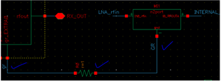

I have a 3 terminal extracted view stitched in my schematic using a n2port. One of its terminal is GR
Is there a way I can alias this GR terminal of n2port with another net in my schematic so that they are connected like a short ?
I wish to connect the floating GR of the n2port to schematic gnd net.

    Here is the image of the n2port where the 3rd terminal is a GR net.
    I wish to connect this to schematic ground net. As of now I am using a small resistor from analogLib to do this but is there a way to short these nets ?

    Why don't you just wire them together (and not give the nets two different names)? If you really want to give them two different names, you could use the "patch" component from the basic library (or Create->Patchcord) to alias the two nets.

    Thanks Andrew, the extracted view was generated from the layout with ground netname GR instead of gr (schematic ground net) so the n2port created after extraction has GR net in i.
    So GR net is coming automatically after extracted view is invoked.
    I can delete GR net and connect the 3rd terminal of n2port to gr directly but not sure if that will impact the functionality of the n2port s-parameter which was originally created with GR net ?

    The s-parameter file has no node names - it just has ports (two ports in this case) - the node names are irrelevant. So you can safely change this without impacting the functionality (inserting the 1ohm resistor would however have a small impact).
