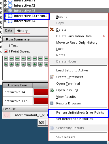

    In situation 1, the reason I don't use "Re-run unfinished/Error Points" is because I sometimes modify the netlist and hence want to simulate the modified netlist (Cadence GUI sometimes have significant delay in response, or just re-generate netlist will takes a few minutes, I don't want to wait). But I prefer the output format assembler gives. Another reason I don't use "Re-run unfinished/Error Points" is because when I have issue with simulation, usually I need to re-start the Cadence to make it clean and work properly. If I don't re-start Cadence, I usually failed to have correct simulation running when "re-run unfinished/Error Points", hence I prefer just start the simulation from the command line, which is more clear/reliable.

    2. In Assembler, even if there is a single corner in your test, there still exists a distinct psf directory that Assembler will access. Hence, without its specific knowledge that the simulation you re-started in the command line completed successfully, it will not update the table of results. You can look in your database with the single corner in the test and you should see the main psf directory.

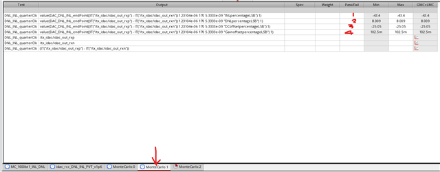

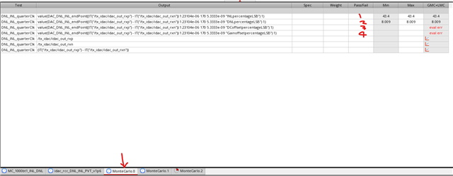

    In MonteCarlo.0 results below, I have my own skill function put in the table, row 1 report 43.4 and row 3 &4 are new function added in skill code. Though I expect after click Re-evaluate button, the row 1 number should be updated to -43 and also row3 &4 should give me a value, it doesn't do so.
    Hence, I decide to start a new simulation, called MonteCarlo.1, as you see, the row 1 value has been updated to -43 and row 3 and 4 also have new values. But I should not need to run MentoCarlo.1 if the re-evaluate button in MonteCarlo.0 works.
    A quick comment regarding Andrew's reply, I tried "full" evaluation in the situation 2 above, it didn't help update the value. The reliability issue, I guess, is related with ICRP process, which handle simulation job submission to grid server. We use RTDA here and somehow the job will time out with no activity before submitting to grid server sometimes. Once this problem happens, it happens always unless I re-start Cadence. I have case reported to the company CAD here some time ago. pending for their reply.

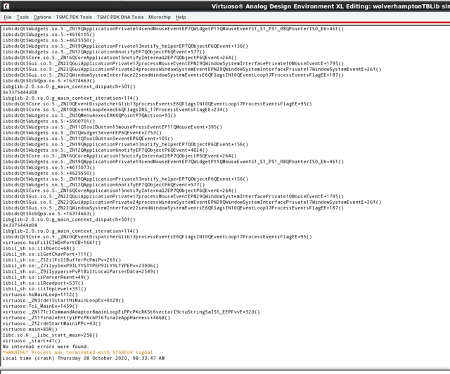

  • monglebest
    monglebest over 5 years ago in reply to monglebest
    I tried "saving the outputs in a comma-separated file, deleting the outputs and reading in the comma-separated file and then re-evaluating?"
    My Cadence crashed.
  • ShawnLogan
    ShawnLogan over 5 years ago in reply to monglebest
    Dear monglebest,
    Rats! That certainly was not my intention ! My apologies...I use this technique quite often to, for example, edit or copy new expressions into the set of Assembler outputs and the process has been robust. Unfortunately, it was not for you...sigh...you might restart a new Virtuoso session and try again if you have the patience.
    Shawn
