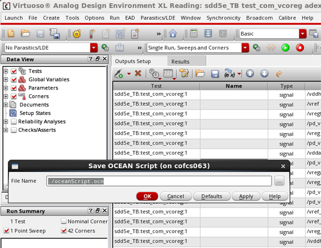

I have a large ADE-XL Simulation with corners where I want to run multiple times with different configurable variables adjusted each time.
E.g.
Sim1: CFG3 = high, CFG<2:0> = low
Sim 2: CFG3 = low CFG<2> = high, CFG<1:0> low
Currently I am running these manually, after saving the DETAILED - TRANSPOSE files to a .csv file. Is there an automated way to do this so that I can just have it run all global variable possibilities and save the output detailed transpose file for me for each?
Thanks

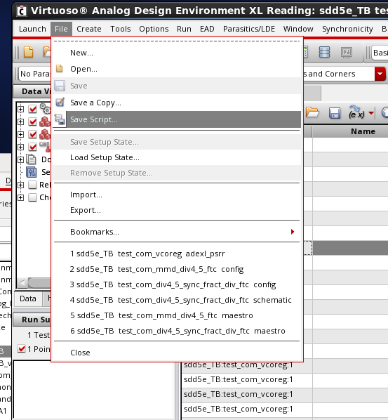

    If you are familiar with ocean and oceanXL, you can create an ocean/oceanXL script to automate the set of simulations. An ocean script can be created from the ADE-XL Menu item shown in Figure 1. You will be prompted to save the script to a file as shown in Figure 2. Documentation on oceanXL may be found at the URL:
    support1.cadence.com/.../ocnxl.pdf
    with a very relevant application note concerning saving comma-separated variable output results at URL:
    support.cadence.com/.../ArticleAttachmentPortal
    As you may know, ADE-XL has been replaced with Assembler and Explorer and hence is no longer actively supported by Cadence. Hence, you might consider migrating to Assembler/Explorer for a couple of reasons life.

    Figure 1 shows the menu that allows you to create an oceanXL script from your ADE-XL GUI. Save the file, as shown in Figure 2, to some name (typically ends in ".ocn"). Did I misunderstand your question?

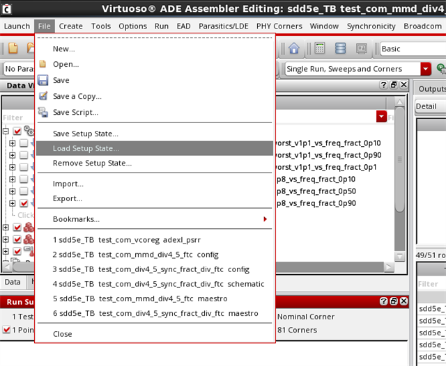

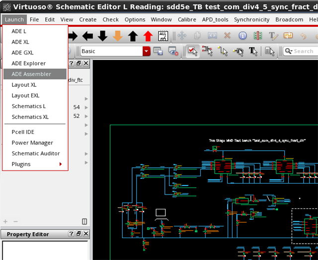

    Open your test bench schematic, and as shown in Figure 3, choose the Launch menu and select ADE Assembler. From the Assembler GUI, you can import a state file from your ADE-L or ADE-XL session as shown in Figure 4.
