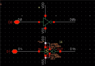

Hi everybody,
I am going to simulate a DCO with TSMC 65nm (However the problem I have does not seem to be related to the type of the circuit).
When I run the simulation, some unkown variable appear in ADE window (circled in the attached pic). Parameters are "intf", "pf", "pPar", "pP", "p", "pw", "e", "nf", "n", "nw". Do you know what these variable are and how should I get rid of them?
Another point is I have this problem with the version 6.1.5, and when I run the circuit with the version 6.1.7 I don't have this problem. (I have to make it work with 6.1.5 version for some reasons).

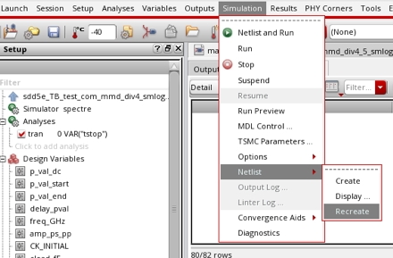

    If the presence of the unassigned variables preclude you from running in IC6.1.5, I would debug the issue using the following methodology:
    1. In IC 6.1.5, create a netlist (Simulation->Netlist-Recreate (See Figure 1)
    2. Navigate to the netlist directory and make a copy of the input .scs file as, for example, 6p1p5_input.scs
    3. Close your session and open a new session in IC 6.1.7
    4. In IC 6.1.7, create a netlist (Simulation->Netlist-Recreate
    5. Navigate to the netlist directory and make a copy of the input .scs file as, for example, 6p1p7_input.scs
    6. Compare the two files 6p1p5_input.scs and 6p1p7_input.scs (UNIX diff, or visual editor tkdiff)

    You are right! Sorry, and  It is now attached.
    Shawn
    Figure 1

    Andrew Beckett over 5 years ago in reply to Mostafa A
    My guess is that a pPar() expression ended up in the netlist (which it shouldn't do normally) and then spectre failed because it couldn't find "variables" used in this erroneous expression, and then ADE added them to the design variable list. Knowing how spectre failed in the first place would be useful (delete the variables in ADE and run again, and then show the error and ideally the line in the netlist that the error is referring to).

    The problem is solved actually. The unknown parameters appeared in the ADE were related to the prepared inverter in 65nm TSMC library (bottom one in the attached photo).. While such inverters have their default parameters values, the parameters will appear in ADE window!!!!     Anyway, I replaced it with the inverter from the 65nm standard cell library (the top one in the photo) and now I don't have problem..Thanks.
