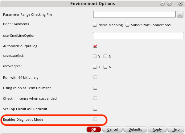

I have developed Verilog-A model of a device that I am trying to simulate and every time it gives different value and at most of the occasions it just stops at a certain time of the simulation.
I have seen multiple posts around the same issue and it seems that this is due to a bad Verilog-A model or varying a bit the convergence parameters.
I would like to get your suggestions of either updating the model or changing the convergence parameters in a matter to get this module working properly.
The model is as follows;

    Andrew Beckett over 5 years ago in reply to AQoutb
    I wasn't suggesting that you replace the input.scs - I was showing that you run with the current source being a PWL source (so use isource from analogLib, and specify the source type as "pwl", or use ipwl from analogLib - they end up the same).
    In the version you're using, it's this on the Setup->Environment form:
