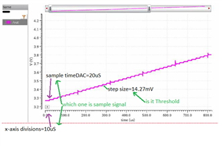

Hi
I'm designing a 4 bit DAC.I have completed the schematic and The output waveform of the block is as follows
I want measure INL error and I use INL function in calculator I try this expression
dnl(v("/net055" ?result "tran") 6.251e-5  ?mode "auto"  ?crossType "rising" ?delay 0.0 ?method "end" ?units "abs" ?nbsamples 16)
and it could't It does not work properly  the output waveform is as follows
Where is the problem?
 is my method to use this function currect ?
THANKS

    Dear mirtaji65, I am confused. 1. You changed the function applied to /net055 from the dnl() function to the inl() function? The dnl() and in() functions provide different results. I thought you wanted…
  • ShawnLogan
    ShawnLogan over 5 years ago
    Dear mirtaji65,
    It appears you did not remove the transient in the beginning of your waveform from "/net055". Hence, I think it will be included in the integration used to determine the threshold option you chose of "auto".  This will not, I believe, provide the threshold you intended. As defined in the manual:
    Auto Threshold Value = integral of the waveform divided by the X range.
    You have the "delay" set to 0, and hence this transient is considered part of your data. You might either clip the waveform before taking the dnl and or increase the value of delay beyond the transient.
    Did either of those thoughts occur to you mirtaji65?
    Shawn
  • mirtaji65
    mirtaji65 over 5 years ago in reply to ShawnLogan
    Thanks for the reply
    lets check together
    firs i changed wave form name:
    a)     inl(VT("/net055") 62.25u  ?mode "auto"  ?crossType "falling" ?delay 0 ?units "abs" ?nbsamples 16)
    The result of the waveform as before
    isn't sampling signal  The amount of output signal increase is actual total for example  62.5u=1v/(16 for 4 bit)
    b) i don't know what really it mean and What  value should I put?
    Threshold--Threshold value against which the frequency is to be calculated. You need to specify the threshold value only if the mode is auto
    c) i choose dealy=.5us half of sample period
    Delay--Delay time after which the sampling begins.
    inl(VT("/net055") 62.5u  ?mode "user" ?threshold 0  ?crossType "rising" ?delay .5u ?units "abs" ?nbsamples 16)
    all of the resualt as the same
