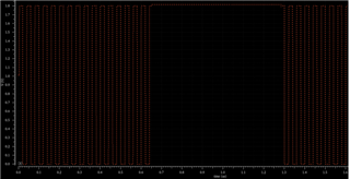

Hi All,
i am sweeping capacitance being driven by a signal in my testbench to see the impact of the capacitor. The signal is a periodic one as shown below from 0 to 1.8v
Is there a way I can get the raise & fall time of the signal plot against the swept capacitance ?
The signal gets skewed as the driving capacitance increases.
thanks

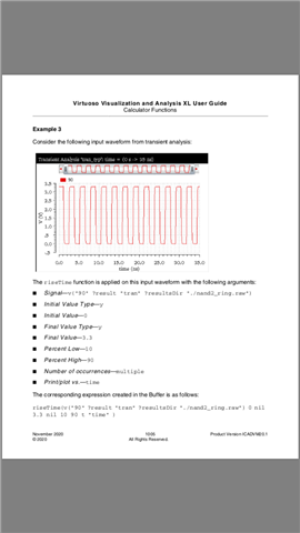

    From your comments, it appears my hypothesis concerning a communication issue between the Parametric tool and LSF is not correct. Based on your uploaded spectre.out file, my thought is now that the "progress bar" is not complete as ADE-L is attempting to compute your added ADE-L output expressions for transition times.
    1. If you are sweeping the capacitance, I am assuming your last analysis is performed with the capacitance at its maximum value. Is this correct?
    2. If it is at the maximum capacitance, are you sure the output waveform is crossing the minimum and maximum thresholds you set for computing the transition times under this maximum capacitance value?
    3. Perhaps if you:
    a. Disable the added ADE-L expressions for transition times and then run the Parametric analysis, does the simulation complete and the progress bar indicate 100%?
    b. Examine the waveforms in ViVA to validate that all cross the minimum and maximum thresholds you set in the rise/fall time expressions.
    c. Enable the transition time ADE-L expressions for plotting
    d. Plot (do not re-simulate) the expressions after selecting the Parametric results by using the ADE-L plot button (beneath the "Stop" simulation button).
    Shawn
