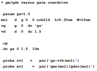

Hi All,
sorry but this question might sound awkward but is there a way to directly plot intrinsic gain (gm/gds) of a transistor using ADE-L or running in spectre as a netlist ?
I have a PDK mosfet for which I am trying to generate the gm/gds versus VGS-VTH plots for different gate lengths.
I have a Hspice netlist as an example below , if this equation can be plotted through a Virtuoso schematic and ADE-L that will be great
.options post brief
.lib 'hspice.txt' nominal
.end
    This has come up countless times before (I'm sure you can find this info with a bit of searching), but here's a very quick outline.
    1. Outputs->To be saved->Select OP Parameters
    2. Click on the transistor - you'll see in the ADE window a new tab showing "Save Operating Points" and you'll see a row with that transistor.
    3. You can then type in the list of operating point parameters you wish to save in the "Operating Points" box for the row containing your transistor (e.g type 'gm gds' (without the quotes, space separated).
    4. Alternatively click on the "..." button, click "Get from simulation" which will run a rapid simulation to retrieve the available operating point params that you can select from a lost
    5. Set up your dc sweep (assuming you're doing a dc sweep)
    6. Run the simulation, and then in the calculator use the "os" (if dc) or "ot" (if transient) buttons, click on the transistor and then pick "gm" or "gds" from the list, and build up your expression - e.g. OS("/M0","gm")/OS("/M0","gds")
    7. You can click on the "gear" icon with a green left arrow to send the expression back to the ADE outputs so that it can be plotted automatically
