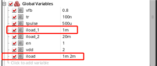

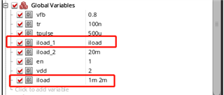

    Thank you Andrew, i got the reason:
    configure sweep variables as left, display a single wave, while for the right, plots of all points arise.
    Andrew Beckett over 5 years ago in reply to Ring Lewis
    I reproduced the problem in the version you're using, and then did some further experiments with other versions - it's fixed in IC6.1.8-64b.500.2. I didn't spot a workaround if you have the sweeps set up this way - the best is to move to a later sub-version (note, I did the experiments with ADE XL, and so you don't have to update to Assembler, even though you might want to consider it).
