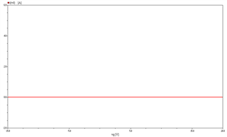

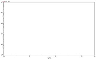

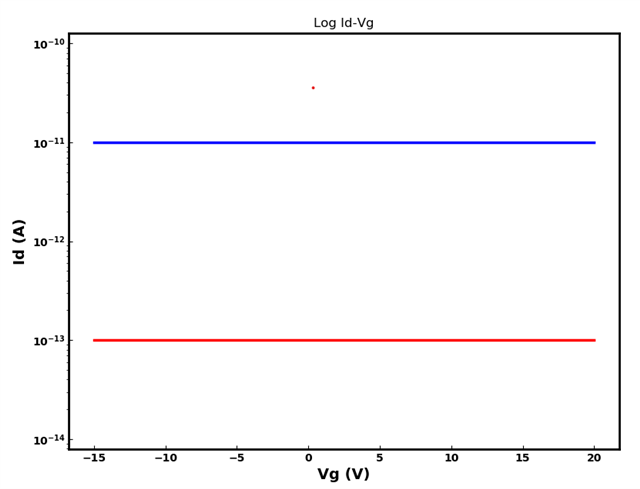

According to the equations provided in spectremod.pdf file (Model reference), aTFT RPI model calculates Ids = I_leakage + I_ab
If we make IOL = 0 and sigma0=0, then I_leakage=0. Similarly, making MUBAND=0 will make I_ab=0. So, Ids should be 0. However, I get a constant current output around 1e-11 for Vd=10V and 1e-13 for Vd=0.1V (100 times the Vd is giving 100 times the constant remaining Id).
I am wondering why this is happening. I cross-checked the code with another program called AIM-Spice which also implements LEVEL=15 atft model. AIM-Spice did not reproduce this behavior and Id was 0 for the above parameters. Is this because of the drain side bias voltage source (Vd) introducing a current?
PS: Circuit file and output graphs are attached for checking purpose.
Spectre output:
Spectre output (Id != 0)
AIM-Spice output:
Linear Id-Vg shows Id=0
Checking Log Id-Vg for values near 1E-15 to 1E-10 shows nothing as expected

    What you are seeing is the gmin conductance that is added across junctions to improve convergence when junctions are off. Given that circuit simulators cannot really handle complete off devices as this…
    What you are seeing is the gmin conductance that is added across junctions to improve convergence when junctions are off. Given that circuit simulators cannot really handle complete off devices as this leads to an ill-conditioned matrix (put simply, a floating node means that you have an infinite number of possible solutions for that node), spectre handles this by placing a conductance (using the option gmin) across potentially off junctions. The default value of gmin is 1e-12 Siemens (so 1e12 Ohms) and this is responsible for the leakage current you're seeing.
    You can reduce it (or even set it to 0) by using something like:
    myOpts options gmin=1e-15
    but bear in mind that this might degrade convergence when devices are off (particularly if set to 0 or a very low conductance). Typically this gmin "leakage" would be less than real leakage in the technology if set appropriately.
  • Jena Huh
    Jena Huh over 5 years ago in reply to Andrew Beckett
    Thank you very much. This fixed the issue.
