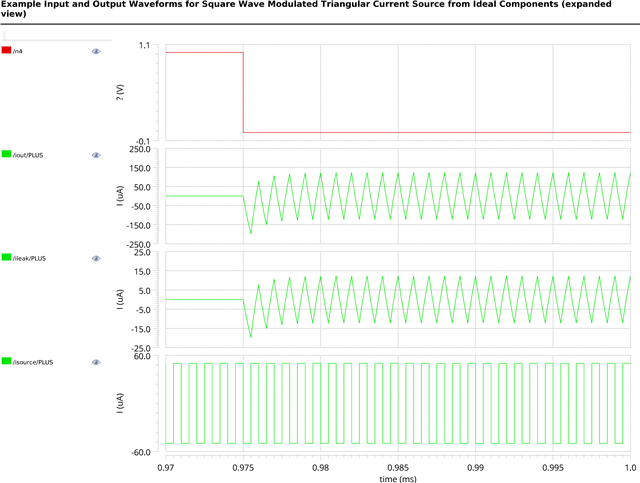

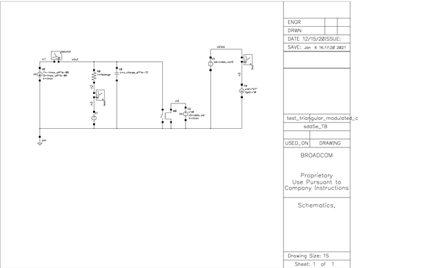

    Dear Johanny Saenz,
    Johanny Saenz said:
    I would like to know how can I can implement a triangule current generator modulated by a square pulse using instances (no VerilogA).
    Sorry for the delay...but in addition to Andrew's suggestion, I thought I might put together a set of ideal components that might be appropriate. Basically, the circuit uses a capacitor and current source  to form a triangular voltage that I then convert to a current through a resistor of value rleakage. I periodically short out the capacitor with a second source to provide the modulation function. I use a controlled current source (current-controlled) with a gain of 100 to increase the amplitude of the modulated triangular current.  If this is anywhere close to what you are looking for, I've included a plot of the circuit (Figure 1) and an expanded view of some of its inputs and outputs (Figure 2). I attached a compressed file with additional plots, the spectre generated netlist (which contains all the parameter values I used), and the plot .grf files.
    Anyway, it may not be what you are looking for, but your request piqued my interest...
    Shawn
    Figure 1
    Figure 2
