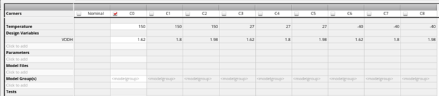

I wish to seeks some advise on performing multiple simulations using ADE-XL. I have to vary a parameter inside the model file whose value changes from 1 to 5. It is a switch provided inside the model file.
Is there a way to add these 5 cases (i.e. changing the value of the switch from 1 to 5) as corners inside ADE-XL so as to simulate all these 5 cases in one go ?
My present corner setup looks as shown below with 9 corners already setup. I need to simulate the above 5 cases at each of these 9 corners i.e. I need to change the value of the switch from 1 to 5 inside the model file at each of the below 9 corners.
Any hints will be great help.

    Hi Andrew adding few more details to the previous message.
    I have 9 corners setup already with 3 temperatures and 3 voltage values as show in the image.
    Now at each of these corner what I have to do as of now is to go inside the model file and change the value of parameter (switch) from 1 to 5.
    The model file is attached in the model libraries. This parameter inside the model file cannot be set as a variable inside ADE-XL and hence i need to manually change it every corner.

    Hi Andrew
    to include the Process variation I need to go inside the model file and change the value of a switch. For example for SS i need to change the value of switch to 1, for FF i need to change it to 2
    I can add a variable with the same name inside ADE XL but that doesn't seem to bring any process variation hence I have to change it inside the model file only at each corner.
    for example to run a corner at Temp = 150degC, vdd= 1.8V across 3 process variation SS FF & TT i will have to go inside the model file each time and update the value of the switch to make it as SS , FF or TT
    Andrew Beckett over 4 years ago in reply to sidm
    OK, if you are just changing the value of a particular parameter on a top level (i.e. not within a subckt) parameters line in the model file, then I think all you'd need to do is:
    1. envSetVal("spectre.envOpts" "netlistModelFileFirst" 'boolean t) in your .cdsinit file
    2. In the test, put Simulation->Options->Analog on the Misc tab, enter "redefinedparams=warning" in the Additional Parameters field
    3. Then define yourself a variable with the name of the parameter in the spectre model file and you can set it in your variables or corners.
    Because the spectre model file is loaded first, then you override it with the value from ADE, and have told spectre that it's OK to redefine parameters (by default it would error out if you defined the parameter more than once), this should work.
