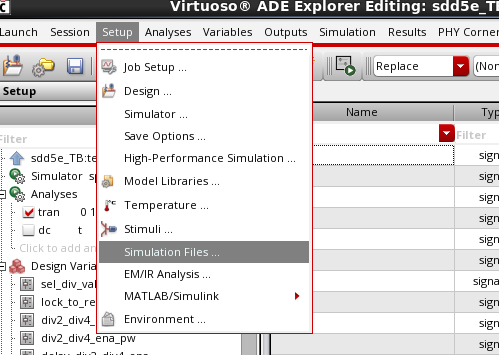

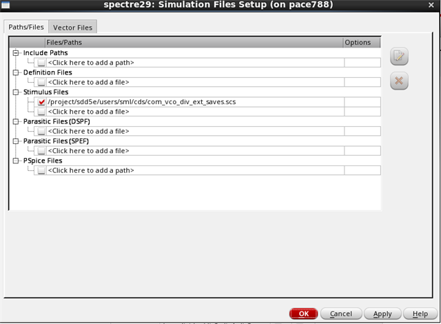

    1. I usually include the added save nets  file as a Simulation file and NOT as a models file. This will put the include statement after the netlist. Did you try this? See Figure 1 and Figure 2 from an Explorer session.

    I've not read through all the details in this post (bit busy this week), but the order shouldn't matter. Other than analysis statements, spectre doesn't have an order dependency here - you can specify saves before the netlist is defined, so this shouldn't matter...
