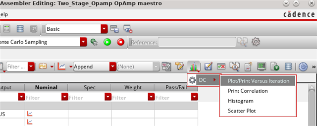

    Having done that, after simulation you can pick this menu from the toolbar:

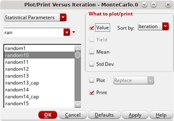

    The "DC" is the test name. Then on the resulting form, you can find the parameter you want (they were called uninspiring things like "random1" in my gpdk-based example):
    This will then display a report of the parameter value for each iteration.
