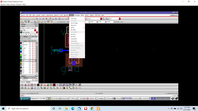

Unable to find RCX in Assura. I am using cadence IC618. I am running it for UMC 0.18um technology.

    Assura RCX was end-of-lifed many, many years ago, and replaced by Quantus QRC. You need to install QUANTUS201 from downloads.cadence.com and have <QUANTUS201instDir>/bin in your UNIX path before starting…

    To add detail, I have run the DRC, LVS but couldn't find the RCX option. Also, there is no assura_tech.lib attached to the technology library. I tried to find this file but I couldn't get it anywhere in the server.
    Andrew Beckett over 5 years ago in reply to KhanAmir
    Assura RCX was end-of-lifed many, many years ago, and replaced by Quantus QRC. You need to install QUANTUS201 from downloads.cadence.com and have <QUANTUS201instDir>/bin in your UNIX path before starting Virtuoso. If you do that, you'll get Run Quantus appearing in the Assura menu, as well as a separate Quantus menu with Run Assura-Quantus in it.
