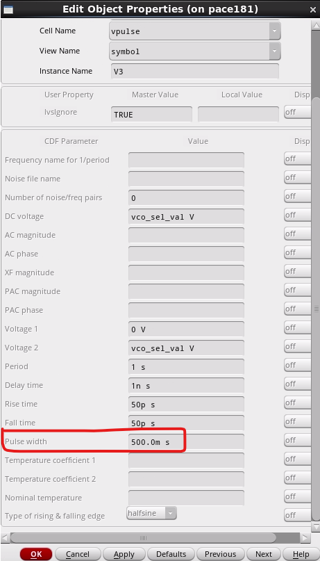

    Thank you for providing your input.scs file! This is quite helpful - to me anyway!
    If you have not followed through with Andrew's suggestion to contact customer support, I think I may have found an issue that will preclude spectre from performing the transient simulation.
    Examining your input.scs file, the input pulse statement to your inverter is defined as follows:
    hikotoshi said:
    V1 (INPUT 0) vsource type=pulse val0=0 val1=vdd period=1/F rise=0.1/F \
    fall=0.1/F
    However, it is missing the "width" attribute. Without the "width" atttribute, it is not clear how spectre can establish the pulse width. From the UNIX spectre -h vsource command, an example vpulse statement is provided below. Note the parameter "width" which is missing from the vpulse statement in your input.scs
    Sample Instance Statement:
    vpulse1 (1 0) vsource type=pulse val0=0 val1=5 period=100n rise=10n fall=10n width=40n
    Did you specificy a width in the ADE setup GUI highlighted in Figure 1 hikotoshi?
    Shawn
    Figure 1
    That still wouldn't cause only the dc sweep results to appear - it would most likely cause either a non-pulse waveform or an error. In practice though, if the width is omitted, it is inferred from the period and the rise/fall times (i.e. I think it's (period-rise-fall)/2). I just tried the netlist (with some made up models rather than looking for the right model files) and it runs OK, and I can plot INPUT and OUTPUT (from command line).
    So that's not it...
    The issue is very unlikely to be related to an error in the netlist - I'm struggling to think of what it might be though, since it doesn't sound like symptoms I've seen before...

  • hikotoshi
    hikotoshi over 5 years ago in reply to ShawnLogan
    Yeah I did not but as Andrew suggested this was sadly not the cause of the issue, as even after specifying a width the graph is still blank. Thanks for the idea anyway.

    Dear hikotoshi and Andrew,
    Thank you, Andrew, for alerting me about the default width setting. I actually examined the analogLib reference for the independent pulse source to see if there was a default width value. From the reference manual, in Figure 2, it suggests there is not a default value - which is what prompted me to include myu comment - sorry! Perhaps, if you think it worth it, I can open a case to request the document I accessed might be updated to reflect the default value's existence?
    Rats!
    Thank you anyway, hikotoshi, in any case for trying my suggestion!
