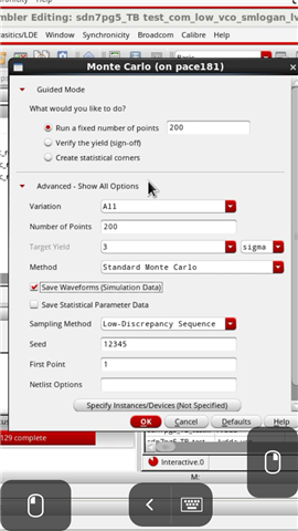

    Dear Jafar,
    Have you included the option to save the statistics for all Monte Carlo simulation iterations? Please see the option I have checked in Figure 1?
    Did I understand your question and problem correctly?
    Shawn

    Jafar,
    I think your question is more of a command-line question (rather than running from ADE that Shawn's talking about).
    I think the simplest is just to use addto instead of to in the print statement:
    print V(Vx1), I(Vx2),name=TRN1 addto="VOUT.out"
    You might need to remove the file before you start the simulation though to stop it appending previous runs.
  • Jafar Shamsi
    Jafar Shamsi over 5 years ago in reply to Andrew Beckett
    Thank you Andrew,
    I really appreciate your help. That's the solution.
  • Jafar Shamsi
    Jafar Shamsi over 5 years ago in reply to FormerMember
    Thank you very much for your response. Actually, I am using Spectre in command-line mode.
