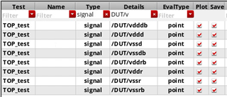

I use inherited connections with explicit inherited pins in my design.
I am able to select these pins after selecting "To be saved..." in ADE Assembler outputs as usual.
When I simulate the circuit using Spectre simulator, currents flowing through these pins are saved as expected.
The problem occurs when I switch to ADE Assembler with AMS simulator (ADE Assembler + AMS + OSS-based netlister with irun).
Despite having set the option: "Save terminal currents: selected" and selecting these explicit inherited pins, nothing gets plotted when I try it. I get warnings like this:
Warning no "IT" data for node "/DUT/vddd"
However, I do not get such warning when I save and plot the current of standard pin. In such case everything gets saved and plotted properly.
I attach several screenhots with symbol and schematic fragments as well as settings.

Symbol (fragment with explicit inherited pins):
Outputs (inherited pin current signals):
Save options (current: selected)
