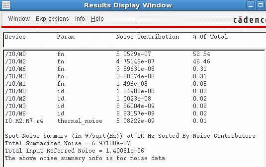

Have a simple RC network with the resistor of polyR type. Run a noise simulation to verify the KT/C noise.
Don't know why "% of Total" column always report 0.
If you see the other posts, like https://community.cadence.com/cadence_technology_forums/f/custom-ic-design/19948/in-noise-summary-report-what-s-the-meaning-of-noise-contribution-and
it has a link at the end showing the expected noise report, which has % of Total. I have repeat my test but still 0 % of total as above shows.

  • Frank Wiedmann
    Frank Wiedmann over 5 years ago
    You have so many small noise contributions that each of them is 0.00% of the total noise power when you round the percentage to two decimal places: (3.31025e-8/5.68804e-6)^2=3.38685e-5=0.00338685%

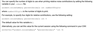

    2. I tried to set the % of total from 2-digit to 4-digit using the command below, but as you see, I have the error. Let me know which is the right command to do it.
    I think you might be missing a backtick in your "int" syntax if I managed to read your screenshot from the CIW. I do not see one prior to "int". . However, one is required as detail in the On-line support article at URL:
    https://support.cadence.com/apex/techpubDocViewerPage?xmlName=explorer.xml&title=Virtuoso%20ADE%20Explorer%20User%20Guide%20--%20Plotting%20and%20Printing%20-%20Noise%20Summary&hash=pgfId-1048767&c_version=ICADVM20.1&path=Explorer/ExplorerICADVM20.1/chap9.html#pgfId-1048767
    So, for example, to set the number of digits to 4, the CIW version of the syntax is:
    envSetVal("asimenv.noiseSummary" "percentDecimals" ’int 4)

  • monglebest2
    monglebest2 over 5 years ago in reply to ShawnLogan
    Thanks, Shawn. It turns out the command I copied from Cadence help, which shown below, has that backtick in front of int wrong. I missed that information. Thanks for your insight.
    envSetVal("asimenv.noiseSummary" "percentDecimals" ?int 4)
