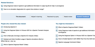

    And if you have another keyword for convergence, plz tell me it, thanks.
    If you are looking for a search term, I would suggest looking at the bottom of the URL pages I provided. Cadence On-line support pages have a section at the bottom of each with links to similar topics. I've illustrated an example as Figure 1.
    Shawn
    Figure 1

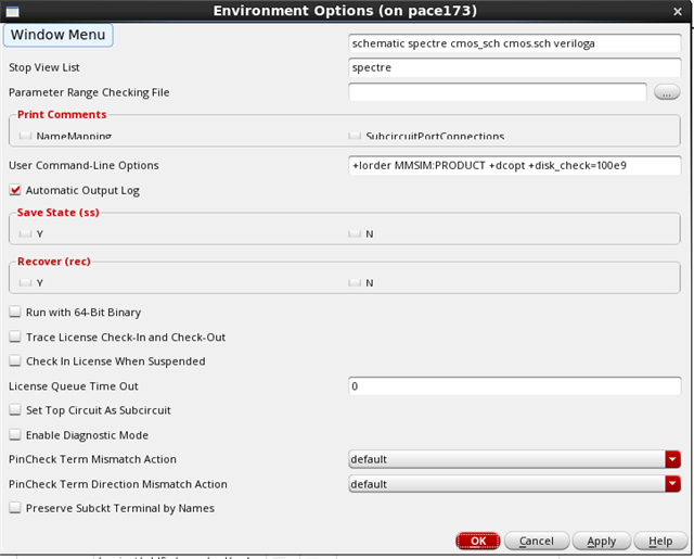

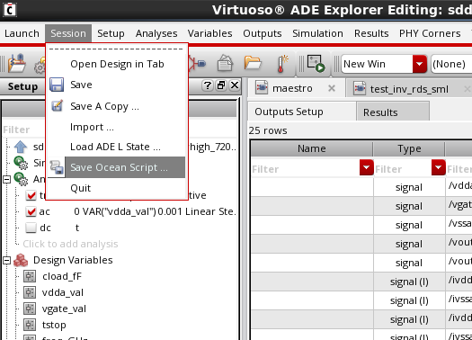

    Did you happen to study the ocean reference manual? It details the envOpt() function which can be used to set user environmental options. The URL on the On-line support site is:
    OCEAN Reference -- Using OCEAN - Selectively Creating Scripts
    with the specific settings shown at the On-line support document
    Virtuoso Analog Design Environment L User Guide -- Environment Variables - ADE Simulation Environment
    As an alternative, you can generate an ocean script directly from a test in Explorer. If you have included +dcopt as Andrew suggested in its user command line options, as shown in Figure 1, when you generate an ocean script using the menu option shown in Figure 2, the relevant syntax for the command will be included in the resulting ocean script. A abbreviated version from the ocean script I just created is shown below.
    envOption(
    'userCmdLineOption "+lorder MMSIM:PRODUCT +dcopt +disk_check=100e9"
    I hope this helps.
    Shawn
