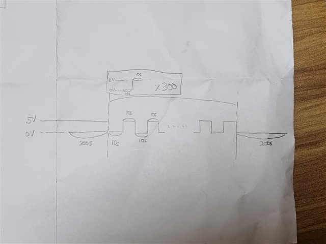

I want to generate a pulse that repeats this voltage pulse at cadence virtuoso schematic. (Fig.1)
                                             (Fig.1 I want to generate a pulse that repeats this voltage pulse.)
However, I do not know yet how to generate a pulse that repeats the voltage pulse in Fig.1
How can I do this?
Please tell me.
Thank you
yysunj
    You can do this with vsource with the source type set to "pwl". You can either specify the points on the form or via an external file (note, you will need to give the edges a finite (i.e. realistic) rise/fall time as circuit simulators don't like ideal edges as that is effectively a discontinuity.
    PWL sources can repeat a sequence if that's what you want.

    I want to generate this pulse. (Fig.1)
                                                                (Fig.1 The pulse that I want to generate)
    I think if I use vpwl to make this pulse the Number of pairs of points will be too large.
    So, it is too inconvenient to use vpwl.
    Therefore, I want to know another method.
    Please tell me another method.
    Thank you
    yysunj
    Andrew Beckett over 5 years ago in reply to yysunj
    Write a Verilog-A model.
