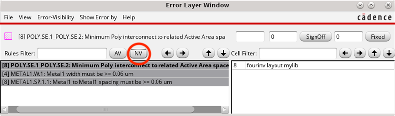

I would like to ask about how to remove the highlights created on the layout after DRC checking in Cadence Virtuoso.
Thank you
Regards
    Which DRC tool are you talking about? PVS? Assura? Pegasus? Diva? Dracula? Calibre? Something else? Which tool version are you using? You've really not given enough information to go on here... Andrew…
    Andrew Beckett over 5 years ago in reply to Senan +1
    Hit the NV button (none visible) button on the Error Layer Window: You may need to redraw the layout window afterwards. Andrew

    Senan over 5 years ago in reply to Andrew Beckett
    Sorry for that,
    I am using Cadence Virtuoso IC6.1.8-64b.500.6, running Llyout GXL, Assura tools V6
    Thank you
  • Senan
    Thank you Andrew for your answer,
    you solved the issue of the DRC,

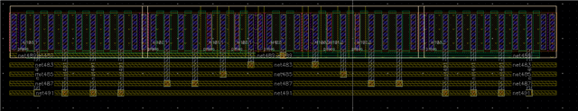

    It looks like I have also similar issue, sometimes a white rectangular appears on parts of my design as it looks as I have pointed on the instance, but indeed I didn't, and those rectangulars still visible even if I click outside, as you can kindly see from the image below
    thanks
    I have no idea what that is. I suggest you contact customer support so that somebody could look at this together with you.
