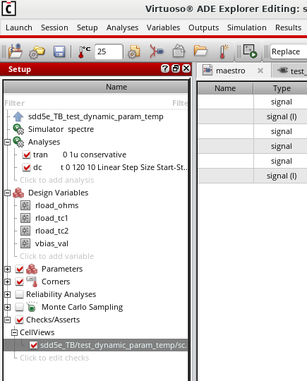

    From the Explorer GUI, the checks and assertions options are shown in Figure 1. As you may know, ADE XL is no longer supported and I would suggest you migrate to ADE Explorer or Assembler. The latter two tools will import your ADE XL state directly and create an Explorer/Assembler maestro state. There is also a Rapid Adoption Kit for the use of assertions at the Cadence On-line support site at URL:

    Figure 1
    I did initially think that the request might have been satisfied by the ability to specify event-triggered capabilities within transient as described in the documentation here: Spectre Classic Simulator, Spectre APS, Spectre X, and Spectre XPS User Guide -- Analyses - Performing Event-Triggered Analysis During Transient Analysis . However, that can be used to describe an event for the dynamic parameters capability, for actimes/infotimes, and for a few other things - but not the stop time of the simulation. The event can be defined by an assert (using the mechanism that Shawn suggested) or a variable in a Verilog-A model.
    The checks/asserts are also available in ADE XL (much as I would prefer you to move to using ADE Explorer/Assembler, I should point out that the UI exists in ADE XL too).
