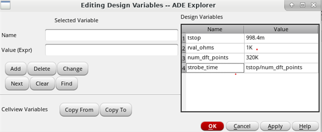

    My strobeperiod was set to the variable "strobe_time" whose value was determined from the following variables in my test bench:

    Now, your strobe time does not correspond to the samples you requested for the dft() and hence your results will have interpolation errors. For such a low noise floor, the interpolation error may impact the accuracy of your result when computed correctly (ie., include non-unit frequency bin width and using averaging on linear data).
    I will attach a compressed version of the Microsoft Excel workbook I used to perform the noise floor computations in my follow-on post (due to size). The specific dft() functions I used were:

    It seems as if your last example should have resulted in the same result I got if you adjusted your strobeperiod to 998.4 ms/320K (which is what I set it to). I also only saved the strobe points (i.e., did not highlight the GUI radio button to "all".
