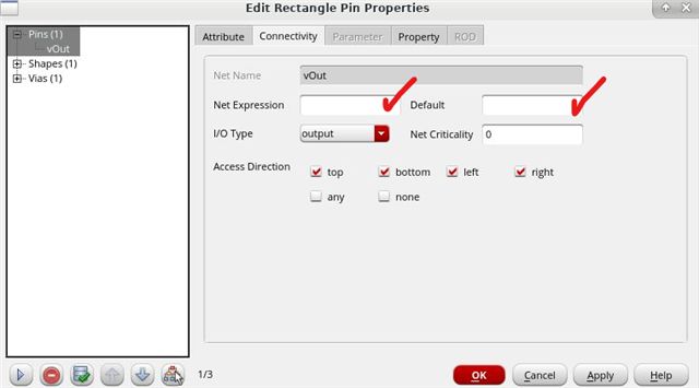

    Maybe I'm violating the posting guidelines, but I seem to fail to find a clever way to modify all layout pins with an existing netexpression. Do you have any tips? It would be a good extended solution to the issue.
    Andrew Beckett over 5 years ago in reply to jjwikner
    No problem - it's all related to your earlier issue.
    A couple of approaches you could take - the first step would be to use the navigator assistant (Window->Assistants->Navigator or pick an appropriate workspace that contains the navigator) and then use the "Pins" section of this to select all the pins. You can then either use the edit properties (Q) and you'll see a list of all of the selected pins on the left side. If you select the Pins (count) at the top, it will then allow you to edit them all in one go - for example:
    Simply blank out the "AS IS" in the Net Expression and Default section, and that will erase the net expression for all the pins.

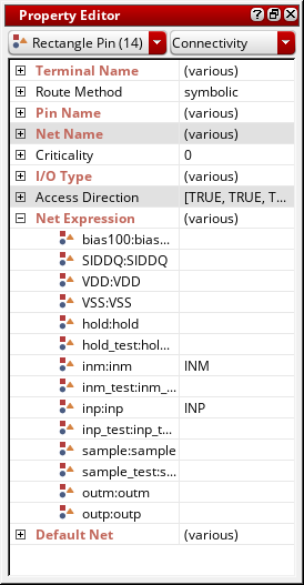

    Or you could do the same with the Property Assistant:
    Where it says "(various)" next to Net Expression, you could blank that out and erase all the net expressions for the selected pins.
