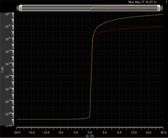

Dear All,
This is my I-V characteristic.
I want to know how can I get tabular data of this result.
How can I do?
Please tell me.
Thank you
yysunj
    Select the traces and then do Right Mouse->Send To->Table
