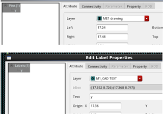

I am trying to draw the layouts for a few cells using the Virtuoso Layout Editor for which I drew the transistor level schematics using the schematic editor.
I use Connectivity ~> Generate ~> All from sources and I select 'ME1 Drawing' as the layer of the pin and 'M1_CAD TEXT' as the layer for the label. These labels are created as Labels and not Text displays.

Notice how the netlist for the layout cell says "0 pins"
Here's the layers in which they are present:
Here's what the report generated by Assura says:
This was initially resolved with a customer support personnel from imec (europractice) for the other cells, yes what I mean to tell is this configuration works absolutely fine for a few other cells.
I am clueless as to how Assura isn't ale to detect the pins. Here's what Layout XL says:
Can someone tell me what could be going wrong?

    maybe, try to use metal/drawing for the pin text. make sure the pin/text are fully enclosed by the polygons in drw purpose (not the pin layer), including the origin of the text. Depending on the outcome, it could either be a deck-related issue or your layout.

    Have you checked that the pin/tax origin is enclosed by a drawing-purpose of the same metal layer? Assura relies on enclosure of the pintxt (a shape converted by textToPin command) by a drawing purpose shape, or the overlap of the two, to recognize the pin and build connectivity. The most common reason for an unrecognized pin is there is no overlap or enclosure of pin text by the right shapes/layers, if the deck works fine with other designs.
  • iamKarthikBK
    iamKarthikBK over 5 years ago in reply to Guangjun Cao
    Yes the pin label is completely enclosed by the shape. the height was set to 0.02
